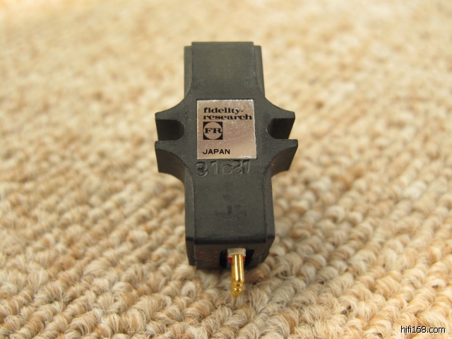

1. Fidelity Research FR-1MK3
Cartridge type : Moving Coil
Output : 0.14 mV
Tracking Force: 2.0 grams
Cartridge weight: 10.5 grams
Impedance : 10 ohms
Frequency Response: 20 Hz to 45,000 kHz
Compliance value : 10X10^6 cm/dyne
Weight : 10.5 grams
这是FR第一款用银线做线圈的唱头,FR唱头不用阻尼垫片,所以不存在阻尼老化的问题。

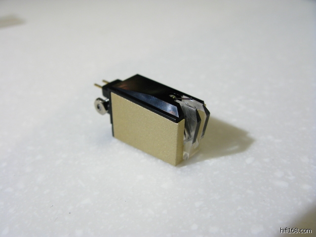

2. Technics EPS-310MC
Type: moving coil
Output Voltage: 0.28mV
Frequency Response: 10Hz - 60kHz
Tracking Force: 1.0-1.5g
Mass: 14.5g
Channel Separation: > 28dB
Output Impedance: 30 ohms
Stylus Tip: elliptical 0.2 x 0.7mil
Cantilever: boron
Dynamic Compliance: 12 x10-6cm/Dyne
这款唱头是用在SL-10一体唱盘上的,需要一个转换架才可以装在通用的唱头架上,声音比Technics现在出的AT-33PTG/EV好太多, 但价格就更便宜。可以说是新不如旧的典型案例。
