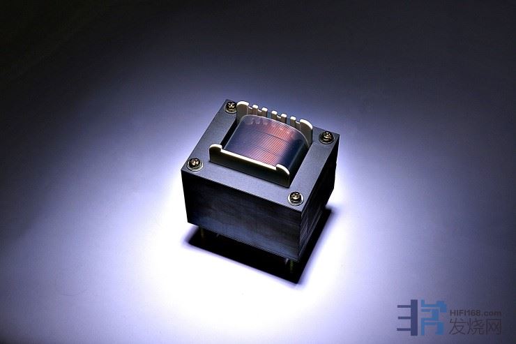

3.    He knows how important thetransformer is in amp making, he does not like  transformer suppiedoutside, every transformer is designed and made by himself and staffs.He haswidest band width and least distortion transformers.
他知道对于制作功放来说变压器有多么的重要,他不喜欢外部采购的变压器。每个变压器都由他设计,并由他和员工绕制。他有带宽最宽、失真最小的变压器。
